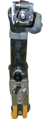

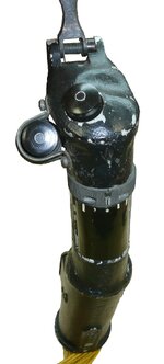

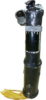

Hi a few comments here, the item list for the ME262B-1a/U1 show:
V52Führertochterkompass mit relais für kursmotor KT/f3 m.FL 23338
The relay in the compass is a output, that the K22 uses for correcting the heading ref inside the autopilot.
And finaly I have attached som photos of the KG13R, on the first you see the heading switch and the second the on/off switch below the R/T botton.

That is fantastic!
I had no idea where the controls were for the autopilot and that setup is way ahead of its time. And so the switch sends a signal to the KT/f3 m which sets the desired course the output of which goes to the K22 autopilot which turns the aircraft relative to the remote compass.
And now I know the exact Fühertochterkompass is the KT/f3. Will I ever find one!?
And the photos are amazing- I even see an original box!
