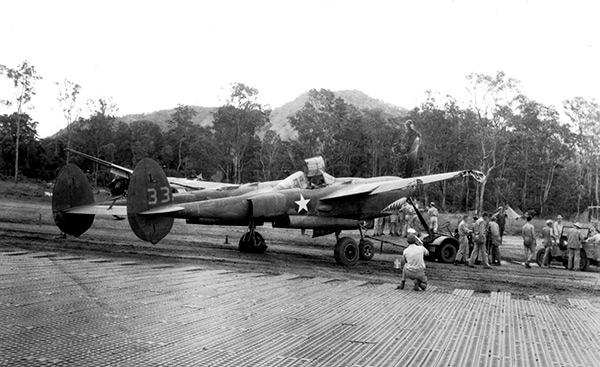

The P-38s first missions in force were actually flown in late 1942 so how can that be? If you want a start of the "tipping point" research the mission flown on December 31, 1942
On December 31, 1942 took off from 14 Mile Drome (Schwimmer) near Port Moresby piloted by 2nd Lt. Kenneth Sparks as one of twelve P-38s led by Thomas J. Lynch on a mission to escort A-20 Havocs, B-25 Mitchells and B-26 Marauders on a bombing mission against Lae Airfield near Lae. Over the target, the P-38s engaged eight Zeros (actually Ki-43 Oscars from the 11th Sentai). During the combat, Sparks fired at a Zero (actually a Ki-43 Oscar) and witnessed it crash. During the combat, Ki-43 Oscar pilot Hasegawa collided with this P-38, damaging the right aileron and wingtip. Returning, to 14 Mile Drome Sparks made a direct landing approach and nearly collided with P-38F piloted by 1st. Carl G. Planck who was also damaged and landing in the opposite direction. To avoid a head on collision, Planck swerved off the runway. jammed on his breaks and narrowly missing the control tower. The P-38s claimed a total of ten enemy "Zeros" shot down. In fact, only Ki-43 piloted by Shishimoto was shot down and bailed out and his fighter crashed into the sea.
Although there were overclaims on this mission, the importance was the ability of the P-38 to provide long range escort for the noted bombers.
