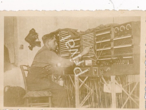

I fact i believe it a part of this Grosser Feldklappenschrank - Axis History Forum
It's definitely not part of the enigma machine itself indeed. That was text based only and the messages were sent in normal morse code.
But enigma was more than the machine itself, it was a whole protocol and I cannot absolutely sure say that it was never used in that workflow. But I'm inclined to say no. And it could very well be part of that Feldklappenschrank that you posted ;)
But It's a cool box nonetheless. The similarities in construction between this and the enigmas is striking.
Judging by the German words there and their translation it is a kind of the telephone traffic control/ telephone tapping device. The "überwachungsschrank" means 'überwachungs" - monitoring and the "schrank" - box/cabinet. So .. monitoring /surveillance/control box. Anyway its smells to me like the Abwehr.
yep ... and just found ... the full set of it and just this device can be seen with the link below .. according to the info there, the only persons responsible for monitoring telephone traffic might use the surveillance box. And the only person was the head of service/ the intelligence officer ( Dienststellenleiter (Nachrichtenoffizier) . The monitoring device also could detect an illegal wiretapping and worked with ( Snautzer01 is right ) the "Der große Feldklappenschrank (gr. FKl, earlier FK-16)" what was the large telephone switchboard/monitoring multichannel station ... see the second link below

Notice sign forbidden to listen in. So no abwehr or the like scenario standard on this type of equipement
Yep .. therefore the box was the additional equipment and could be attached when needed.
