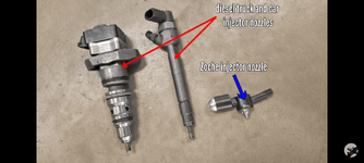

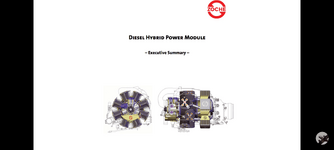

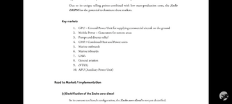

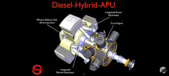

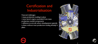

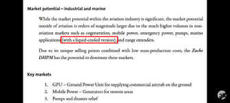

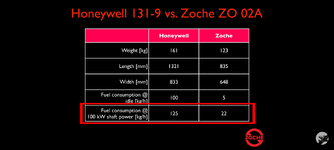

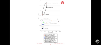

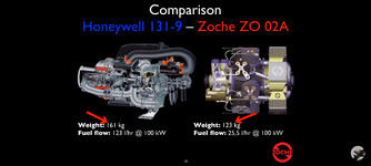

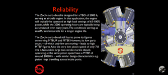

Let's Go Aviate has a very long overdue update on Zoche Engine progress which looks very promising. More efficient, more power, much bigger market potential = reduced costs... Boeing and Airbus interested to use as a much better APU replacement for the Honeywell 131-9.
View: https://youtu.be/wAb_vxdYLUI

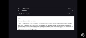

The Zoche diesel looks good on paper, and the latest iteration with an electrical hybrid turbocharger is an interesting enhancement, notably Porsche has done essentially the same in the latest 911. And targeting other markets outside GA makes sense, considering how small and moribund GA is.
However, Zoche has been promising this or that since the 1980'ies but has yet to deliver anything to the market. Not holding my breath.
