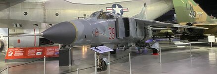

In case it might be useful to you in some way, here is a photo of a MiG-23MS that I took last month at the National Museum of the United States Air Force in Dayton, Ohio. I don't know why I took only one picture of this plane. (I took a total of about 400 photos that day, and I think my brain was fried by the time I got to this plane!)

What is this Hybrid ML and MLD? As I understand it, this is one of five aircraft received by the National Museum of the US Air Force from the former GDR on March 27, 1991. The original B/N was "Red 338", although the West Germans applied "Black 20 15". Served in the 9th Fighter Regiment of the GDR Air Force.
View attachment 840698View attachment 840699
As memo serves the MiG-2 is a mix of the ML variant ( NATO code Flogger G) and the MLD ( NATO code Flogger K ). The tail is from the MLD while the rest is of the plane from the ML. The MiG 23ML serial number 0390324630. It means tha the tail section is not the orginal one.
MiG-23ML – version with improved handling characteristics thanks to a reduction in the aircraft weight by 1,250 kg (L - as in "Light"), with a new R-35 engine with slightly higher thrust, with modified electronic equipment.
MiG-23MLD – a modification of the ML version, D - as dorabotanyj ( Д – доработанный ) - refined, with improved aerodynamics improving the maneuverability of the aircraft.
