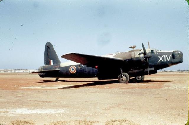

The enlarged shot of the Wellington reveals that the yellow outlined the roundel was there. The dark thin outline can be noticed. IMHO the pic was taken with the orthochromatic negative.

I've had a closer look at the pic and, although the Wellington could be Greek, there appears to be an outer "ring" to the roundel, appearing dark in the photo. It looks like a filter or perhaps ortho film may have been used when the photo was taken, so this outer "ring" may very well be yellow.
This could signify RAF, but, although the contrast of the other colours in the roundel don't allow positive I.D. look at the fin flash.
The forward stripe appears lighter, and the aft stripe darker, which leads to me to believe it is French, with the "French Blue" stripe forward. RAF fin flashes had the red stripe forward.

I agree with you my friend. The roundel size and the proportions for each colour of the marking indicate the L'armee de l'air. Also the "white J" looks like the French marking rather than the RAF one.

Regarding the Wellington, I think it's a Mk.X and it is unarmed, the turrets have no guns in them, so it might have been ferried at the time of the photo. It has Rotol props and spinners, which were not normally fitted to the broadly similar Mk.IIIs in RAF service. The large J marking is unusual as I don't recall seeing anything like that in that position on a British Wellington, but it does appear to be French, if I was to hazard a guess. Here's a link to a picture that might assist:

As an observation, didn't the Vichy French keep the traditional roundel and the FAFL use the cross of Lorraine as their insignia?
Generally speaking, yes, but given the picture I posted a link to, I'd say that was a Free French Wellington, I suspect the Vichy French did not have Wellingtons. Bearing in mind the Wellington's British, so it might have been delivered with markings painted differently to standard French ones.
from this forum:
Squadron 344 (or Flotille 2FB) operated XI and XIII.
Its Wellingtons were initially received at Port-Lyautey (Morocco).
It was credited with the sinking of U-403 on august 1943.
And as General Recce (ASW) aircraft they were in Coastal Command camouflage with white undersides and the “stickleback” aerials of ASV.II on the aft fuselage.

Given how pristine the Wellington paint looks the photograph could be at a rear area location.
Wellington X LP706 taken on charge 21 June 1944, is listed as MAAF 8 August 1944, and sold to FAF 12 July (year unreadable). Looking at nearby serials, all Wellington X, LP650 FAF 21 June 1945, LP653 FAF 28 June 1945, LB684 FFAF 30 June 1946, LB686 FAF 29 August 1946, LP750 FAF 29 August 1946, LP758 FAF 5 July 1945, LP784 FAF 5 July 1945
344 Squadron formed Dakar 29 November 1943, ex Flotille 1E used Wellington XI and XIII until transfered to French control 27 November 1945. Essentially it was the sister squadron of 344, ex Flotille 7E with Sunderlands, same dates and locations.
U-403 has several causes of loss depending on reference, 200 Squadron records a U-boat attack on 17 August 1943, the submarine was spotted at 0920 hours. Uboat net has it sunk on 18 August by HZ697 of 344 squadron after an unsuccessful attack by 200 squadron earlier that day. Kenneth Wynn says attacked by a 200 squadron aircraft on the 16th, then sunk on the 17th by 200 and 697 (Free French) squadron.
Mark XIII HZ697 was taken on charge 11 June 1943, to North Africa in 1943 (serials around it say they transferred late August/early September) It is listed as going to the French Air Force, along with HZ696, HZ704 and HZ770.
