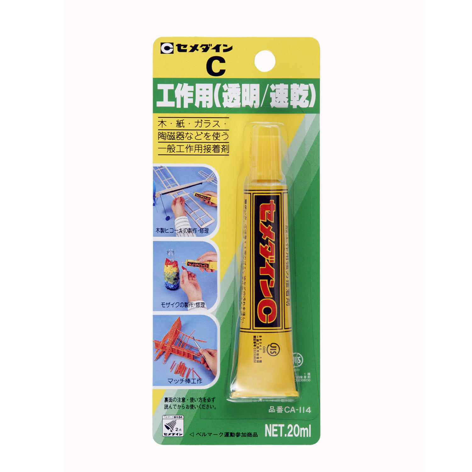

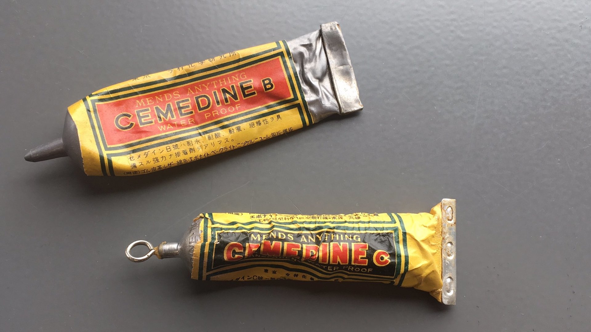

Cemedine glue then and now.
I did not know Cenedine is Japanese product.
Cemedine (prewar)
Cemedine (modern)
Nice. What kind of the adhesive is the Cemedine?
Type C belongs to the nitrocellulose adhesives.
In my experience, Cemedine type C is not so quick as cyanoacrylates but not so slow as silicone type.
I see. Here in Poland the most known nitrocellulose adhesives are "Hermol 85" and AK-20. The Hermol can be used both for plastic, paper and wood. However the AK-20 is better for wood and being thinned also can be used as the impregnate. But there is a clear coat called Nitrocellon. It is of the same kind the AK-20 glue. All these adhesives are used widely for modelling. The Nitrocellon is used for wood protection and impregnating of what we call "japanese paper" - the very light skin for models. I'm sure you know what I'm talking about , my friend.
the pic source: the net.
I am not a scale modller, so please let me tell our general situation about the synthetic glues.
Cemedine type C was originally developed for the general purpose, including scale modelling, when there was no synthetic glues except British MENDINE in the 1920s. I also loved it when I was younger as it was convenient but have no chances to use it anymore as the cyanoacylates adhesive represented by Aron Alpha is quicker and stronger than type C but not satisfactory for cloth, wood, leather or paper as absorbed as well as synthetic plastics like PP/PE/PET as not sticky. On this point, Cemedine type C is still good for the cloth and wood, or paper, but water-based bond is much better for the purpose if you are not in a hurry. Konishi Bond offers several good adhesives for the leather and rubber. Scale modellers do not seem to use type C at least for plastic models but the dope cement type like Cemedine CA-216 or AX-243.
