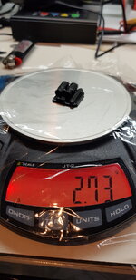

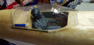

Hello everyone,
Really sorry for the late reply, did not see there were so many responses yet.
I appreciate the pictures and very detailed explanation on the subject.

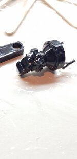

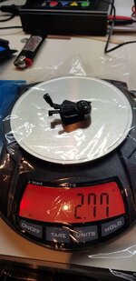

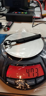

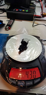

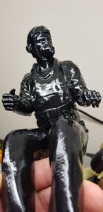

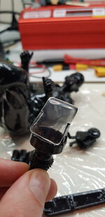

I'm designing the seat for my 1:6.9 scale RC model of the MK VIII (running a 20cc 4-stroke engine) to be 3D printed and put in my Spitty.
I can kinda eyeball it, but as I've done all other items as close to realism as possible I was hoping to find some dimensions to make life a little easier.
What I've done so far you can see in the attached pictures.
I've already found a few op the plans you kind forum members have sent, but a few I did not have. I'm going to do my best to make it as real as possible.
Again many thanks for your time and effort to respond!
Kind regards,
James from The Netherlands
