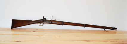

My prize was, and is, in remarkable condition. The receiver looks like it was put together yesterday. I have had the rifle completely disassembled, cleaned and put back together and that's all it needed. I am told it will fire, no problem.
As for its provenance, the stampings and numbers discovered during the disassembly indicate it as a Birmingham built commercial model, confirmed by the Royal Armouries in Leeds. The rifle was provided to either the United States or the Confederate States during the American Civil War, but without knowing when it was built/delivered, it would be guessing to say it went to one side or the other. According to what I read, the Union ceased purchases from Birmingham in late 1863, but the Confederacy continued to deal with them.
