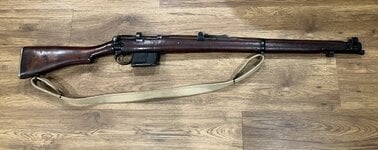

After the mention of the Ishapore .308 Lee Enfield here, I decided to look at my own Ishapore 2A1 rifle.
It appears to be in pretty good shape, but I never spent any time tuning or inspecting for accuracy bugs in the gun.

This is my 2A1 rifle. It is in much nicer looking condition than I remembered it.
Note the Ishapore squared front sight protectors. I really don't like those.
These are the markings under the bolt handle. I can't quite figure out what is on top.
It sort of resembles a crown but not quite. For this type of rifle, 1966 is not particularly late production.
They were manufactured well into the 1970s.
This is the distinguishing feature of the 2A1 as versus the 2A rifle. The 2A has sights out to 2000 Meters / Yards.
There may be other differences, but this is the most obvious.
My intention is to inspect this rifle to the best of my ability and tune it for accuracy in the same manner as a SMLE No.1 Mk.III.

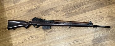

The FN-49 or SAFN was a very widely distributed rifle. In the United States, we typically see just the 7.92 x 57 that was manufactured for Egypt, but there were many many others. The Belgians themselves used a 7.65 mm version as did one of the South American countries (Argentina?).
The Venezuelans used one in 7 mm Mauser. The Colombians used a version in .30-06 on a slightly longer action. My understanding is that most of these countries never put these guns on the surplus market.
For a short time I owned a custom conversion of one to 7.62 NATO. I believe the fellow who made it (a friend of mine) took a M1903A3 Springfield barrel and machined it down. The problem was that he didn't really figure out the sizing of the gas port correctly from what I could tell, so even with the gas vent completely closed, it would short cycle most of the time. I sold it back to him. It would have been a cool rifle if it had been made with a 4 groove barrel instead of a 2 groove and been somewhat reliable in functioning.

It is a pity about the FN-49. Venezuelan guns are pretty rare in this country. The FN 49 is pretty typical of the wood and steel battle rifles of the 1930s. They were a bit big and clunky.

The FN-49 / SAFN really are nice rifles, but they do have a few engineering flaws. The quality of manufacture is quite excellent. As you mentioned, they are a bit on the heavy side but that is generally what happens with solid steel and a dense hardwood stock. The major flaw in the design is that it has a tendency to break firing pins. This is a gun that should not be dry fired. On some of the later manufactured guns and firing pins, they were made in two pieces so that the tip which was long and thin and had a tendency to break could be easily replaced without replacing the rear which had more complicated machining. The replacement tip looked very much like a nail.
Some of these rifles were machined on the left side of the receiver with a dovetail for mounting a telescope. I believe these guns were quite accurate enough for the purpose. I have fired the Egyptian contract 7.92 x 57 mm the most and it was doing about 2 inch 5 shot groups at 100 yards with the iron sights.
These guns had quite a few variations in small features depending on the contract.
There is little question as to who the original user of this rifle was.
