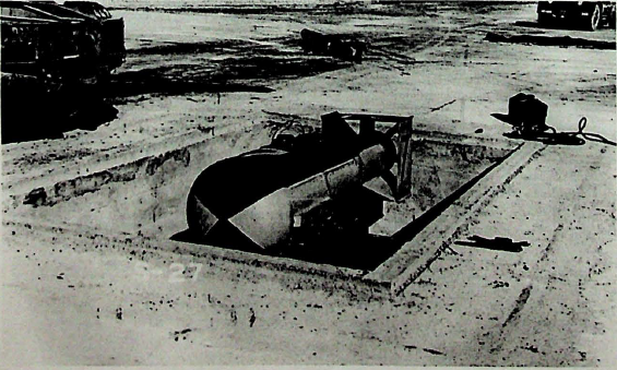

Ok, it looks like I should have been a little clearer in my comment about the three bombs.
Little Boy and Fat Man were (as we know), deployed in combat.
Thin Man was aborted for several reasons, one of which, was it's design being extremely problematic.
It was Thin Man's size (17 feet long, 38 inches wide and weighing 8,000 pounds) that brought up the subject of a Lancaster being used to deliver it, however, that was quickly ruled out.
Instead, a B-29 (42-6259) was selected for the "Silver Plated Project" and had modifications to carry Thin Man, which included modifying the bomb bay, relocation of oxygen tanks and so on.
Another issue was the bomb release system, which failed during the test mission on 16 March 1944, causing the bomb to fall into the bomb bay doors while enroute to the test site, causing a great deal of damage.
It was this incident and the issue of Thin Man's fission complexity, that caused it to be abandoned.
The one upside to this event, though, is that a British bomb attachment and release system was used.
But anyway, my original point was, that there were three bombs originally built during the war, two were used, one was scrapped.
