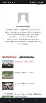

The author of above article about laminar vs turbulent airflow article is knowledgeable in the industrie. I guess he knows about tolerances and weight...
I heard him talk at Oshkosh a few years back. He knows his stuff, except when he fell for the Stirling wingspan hangar limitation myth.

Barnaby's article was aimed at homebuilts, which usually are not stressed metal skin.
