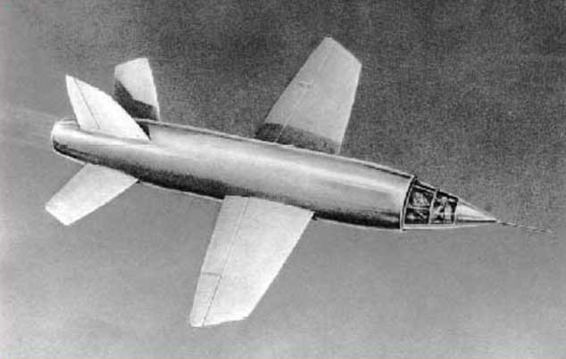

Copied from the British Miles M.52 supersonic research aircraft that got cancelled (But not for that reason!)?
