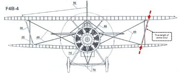

I had sourced some 1/48 scale line drawings of the F4B some time ago (unfortunately I can't recall where I got them – intraweb somewhere, but they are tagged with the drafter name – N. Okolelov). The F4B-3 is reasonably close to the P-12E, especially in terms of general layout of wings, struts and tailplanes, so I used this (and the F4B-4) as a basis to determine what the actual outboard strut length should be. I initially had a concern that I would not be able to determine what the true length of the strut would be, but after establishing the centre post is basically vertical, it is then easy to use the front view as an accurate representation of it's true length.

Now having some dimensions to work with I set about creating a template to assist in aligning the struts once I started to put them into place. Like I had done before for a biplane build a while back, I used clear acetate from some packaging and set out the centre points for locating the struts. To keep the acetate straight, I CA glued a length of sprue as you can see on the photo below. This allowed me to set about fitting both sets of struts.
