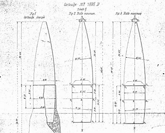

A number of countries used boat tailed bullets but part of the "trick" here is that the Americans and British did not use them in "standard" rifle ammo. They used them in standard machinegun ammo. What were Aircraft machineguns using?
German bullet might very well be better than the American & British bullets but they are going to be close.
French were using spitzer boat tails from around 1898.
this may not be as good a design as the German bullet, actual difference may have been small in practice. French bullet design may have been good. The cartridge case sucked.
