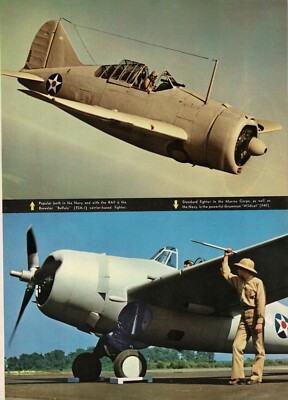

Here is a nice little shot. Comes from a set of prints produced by the Curtiss-Wright Propeller Division during the war years.
Nice set if you can get your hands on it . . . obviously I have . . . think I'll trot over to the F5F thread and post the shot from this set over there..
