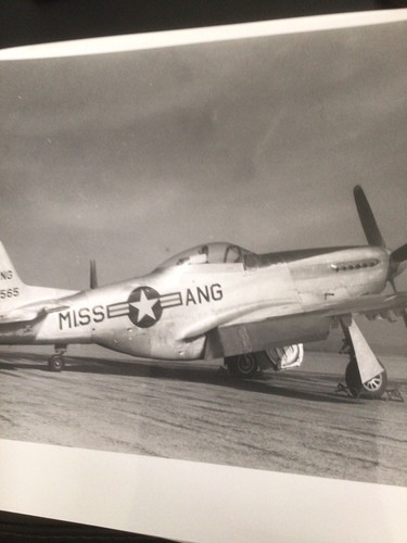

P-51D-30-NT 45-11565 Miss - ANG 153 TRS
As memo serves .... the Missouri Air National Guard

Actually, it would be the Mississippi ANG, P-51s with the Missouri ANG would have been identified with "MO*NG".
I'm really getting older . Glad you reminded me. :) :thumbright:
