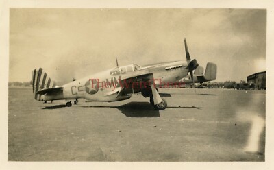

That is Bickell's GQ-A 355th FS/354th FG circa May 1944
With the passing of the years and a few more dead brain cells than I would prefer, the publication of this photo on this site inadvertently reminded me that I hadn't lost all my marbles. As other have already noted, this certainly wasn't an A-36 or any other Allison-powered Mustang - it was a P-51B or C. The tail stripes (red) placed this aircraft in the 31st Fighter Group, Fifteenth Air Force. But the "MM" squadron codes made no sense - I'd never before seen them on an AAF fighter. No matter, there are plenty of things I can't explain.
So the better half and I went out to run errands for a few hours. We were driving home on the highway when I blurted out "Charles M. McCorkle!" (We've been married a few decades now, so she's used to my strange declarations.) It turns out I published a photo of the opposite side of this aircraft on page 79 of Air Force Colors, Vol II in 1980. Due to space limitations with the star insignia, the pilot (and group commander) has his initials as CM*M on the Mustang's left side.
Nice to now have both sides of the aircraft, and to know that I'm not completely bonkers...
Cheers,
Dana

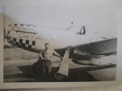

P-51D-25-NA 44-73060 Dove of Peace VIII 353rd Fighter Group ETO
Col Glen Duncan's last ship. He was shot down by flak over Holland in P-47D July 7, 1944. He evaded capture and fought with underground until over run by Allies. Returned to command the 353rd in April 1945 till EOW.

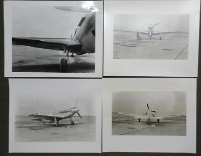

looking for pics of one of the two XP-51B prototypes, the final one with the eventual rad intake.
Seeing if I can merge the Ac Min P-51 with the nose and intake of the Acc Min P-51B. Going well so far, but need to sweat the details.
I think what I have is all there is, but never hurts to ask.
I have a few of the Ames wind tunnel set, but would love higher res items.
Didn't NA do walkaround shots of all the aircraft on the apron?, I only have low res side shots, nothing else.
Both XP-51B had the final intake scoop installed. 421 first at Ames, then 352 with production scoop - as all early P-51B-1-NA already released but awaiting 1650-3 engines from Packard. For example 43-12093 (#1) had flat intake scoop when first photgraphed but replaced before first flight tests by Chilton in May 1943.
The image Snautzer published earlier was #1, the one that did Not go to Ames.
Yes to walkaround shots, but many forever lost when Rockwell absorbed. I have high res images of 352 and 421 bt have to seek Boeing's permission to display (theoretically only to publish) as they own copyright to all NAA products. So many on eBay are products of the NAA photo with the bottom photo ID cropped..
