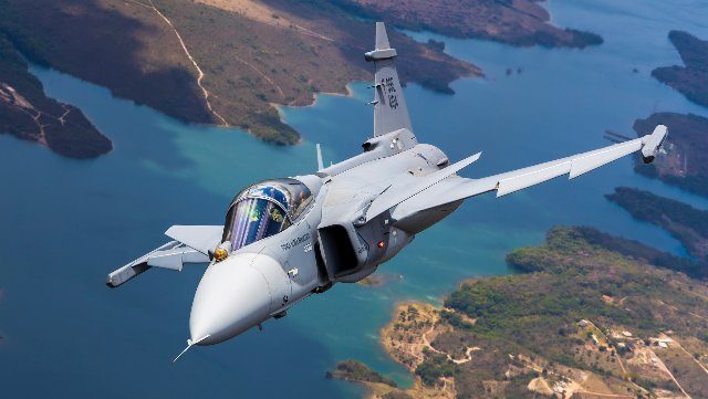

JAS 39 Gripen is growing up.... (3 Viewers)
Photo by Sgt Müller Marin
