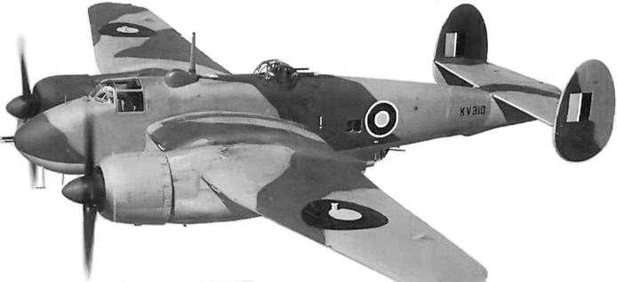

Whether the Hampden was at a time the only medium bomber type is unclear, by the time it entered production the 4 engined types were on the way, Blenheim I 8,200 pounds tare, IV 9,780 pounds, Wellesley 6,812 pounds, Whitley V 19,350 pounds, Wellington IC 18,556 pounds, Hampden 11,780 pounds but nearly the same maximum bomb load as the Wellington Ic.
the Hampden wound up being the loser in the "medium" bomber derby. Handley Page ended production in July 1940 (probably to build Halifax's) Good old English Electric stopped production in March of 1942.
From Wiki
"Almost half of the Hampdens built, 714, were lost on operations, with 1,077 crew killed and 739 reported as missing. German Flak accounted for 108, one hit a German barrage balloon, 263 Hampdens crashed because of "a variety of causes" and 214 others were classed as "missing". Luftwaffe pilots claimed 128 Hampdens, shooting down 92 at night"
The Whitley stayed in production until July of 1943. perhaps in small numbers but it was much more useful for ASW.
Hampden Production,
Handley Page, 502 including 1 for Sweden, September 1938 to July 1940
English Electric 770 March 1940 to March 1942
Short Harland 150 Hereford August 1939 to September 1940
Canada (2 lines) 160 September 1940 to May 1942, from which 85 airframes were imported into Britain.
