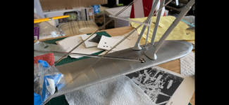

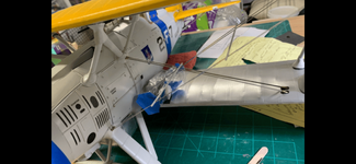

In response to your request for more detail on the javelins, I just happened to have taken some additional photos during this process.
I took out my stock of plastic tubes & rods & just randomly picked out a rod that I felt approximated the thickness of the javelin to the scale of my model.
Because the packet contained various sizes of rods & tubes I couldn't give you a definite answer to the diameter but from past experience I'd say its around .060."
From there, I carefully measured the distance between the fore & aft rigging & took into account the overhang. This was done by eyesight & comparing the lengths with various photos of the full sized aircraft.
Using my X-Acto blade, I cut four lengths.
Then I quickly spray painted them using the same color as the light gray on the airplane.
I then used Scotch double sided sticky tape & applied the outer most rod to what I thought looked "about right."
The location of inner javelins are predetermined, based upon the crossing of the flying & landing wires. So no guessing there.

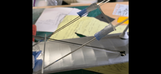

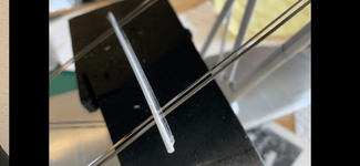

Using the preapplied javelin rod as my guide, I carefully stuck some used de-tacked masking tape to help locate & hold the freshly painted rod in place until the glue dried. I used the detacked masking tape because I felt the last thing I didn't need, was for the strong adhesive backing of fresh tape to pull the rigging out of alignment or worse, pull out the rigging altogether.
From there, I used clips to further enhance the glue to the rigging.
Hope this helps.
