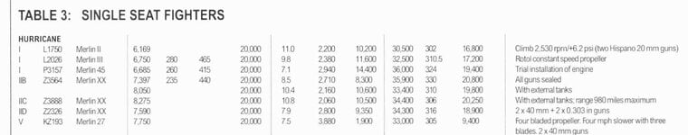

When you make these incredible statements, you have to be challenged on it:
"But the F4F had almost three times the range of the Hurricane"
The Hurricane IIA/B/C has 97IG of internal fuel and used two x 44IG DTs. Range on internal fuel was ~450 miles with reserves and with DTs ~950 miles with reserves.
The IIA data card shows a range of 500 miles (at 212mph) at 20K ft with a 29IG allowance for TO and climb to 20K ft.
F4F-4 has 120IG internal fuel and could carry two 48IG DTs.
How can the F4F-4 possibly have almost 3 times the range? We all make mistakes, so why not admit to one here and then we can carry on with an interesting discussion.
