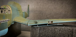

Just back-tracking to an earlier time in the build, when I was dry-fitting the dive brakes, and noticed that the locating pins are too close together compared with the holes in the wing for them. Result: bent dive brakes.
I cut down one pin to allow them to sit parallel with the lower wing.

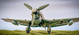

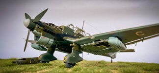

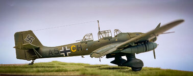

Believe it or not... it's finished. Tail plane finally on (supporting struts didn't fit too well). The cowling fit is atrocious, but removed displays a bit of the work I did on the engine. Some thinned black sprayed to cover the exhaust stains, minor chipping and scrapes with a silver-grey pencil, and added the final fiddly mass balance do-dads on the ailerons and footsteps. Wing machine guns left over from my Fw 190 build. Uschi rigging for the aerial wire. Worked hard on trying to make the landing light glass fit better, but it's pretty ordinary. Needed a lot of sanding, polishing, and a gloss final coat to make it a bit more see-through. I tried and tried to fit the Eduard photoetch gunsight on the MG in the rear canopy, but my "essential" tremor made that impossible. I'll just have to move up to 1/24 scale I reckon...
Anyways, I'm pretty happy with my first Stuka. Don't think I'll be going the Italeri road for my second one though...
