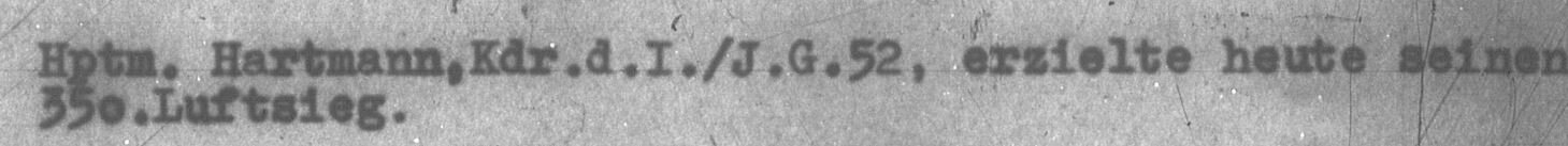

1945.04.17Hptm. Erich HartmannI./JG52----NARAErfahrungsbericht JG 52; Picture350

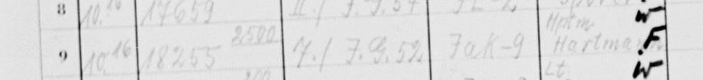

In your opinion, and you are welcome to it. I wasn't there and can't say for sure.
But, the evidence survived for the victory board discussion. Most pilots, including the Germans, didn't put in for a victory unless they saw the plane explode or otherwise go down, the enemy pilot bail out, or the plane going down into cloud while substantially on fire and seemingly out of control.
Then again, as I said, I wasn't there.
Cheers.
