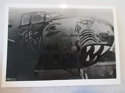

Found this doing a reverse image search on Yves photo. Google calls the images "B-25G Tee Kay". Italeri does a 1:48 B-25G kit and one of the decal options is for Tee Kay.
Image isn't clear enough to get the serial number unfortunately
Edit: s/n is 265217
