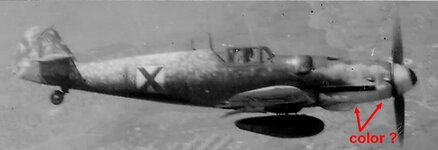

Hello,
I've a doubt and I need opinion/information. I've a doubt regarding the color of the underside of the cowling: RLM76, RLM04, both ?
Steph, it's 76.
Check my post # 28 with 3 photos of the same a/c during different periods. The top one is from the time when Bulgaria changed the sides and the airplanes received white recognition markings. If you check the cowling it looks the same as in the earlier photos and doesn't show any signs of overpainting at all.
Cheers!
