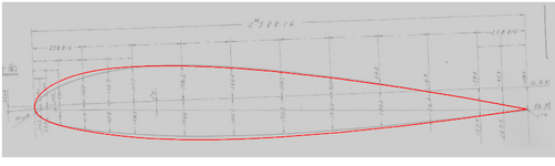

Do you have any information the Mitsubishi B-9 airfoil, used on the Ki-51 (and I think the Ki-21)?
Mitsubishi B-9 airfoil aka Blackburn B-9 airfoil seems to have been adopted by many Mitsubishi planes like B2M, G3M, Ki-15 and Ki-51.
Max wing thickness is known 16%.
If this G3M drawing is correct, position looks 30%.
Shinpachi Shinpachi
Can you post coordinates for the B-6 airfoil?
I only traced the drawing :smile:

This is interesting. If I take the A6M2 wing root airfoil (the MAC118) and scale it from 14.24% thickness to 17.11% thickness and scale the camber from 1.846% to 2.112%, I get a pretty close overlay with the Blackburn B-9 airfoil!
Was it really that thick at the root?

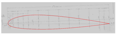

Do you know anything about the airfoils used on the H6K or H8K?
Sempill Mission
Ahh the spying game. The un wanted co operation game.
Thievery is i think not co operation but all sides did I suppose. Still do. No shame in that.
The connection between the British Royal Navy and the Japanese was long standing, the only surviving pre dreadnought battleship in the world was built by the British at Barrow for the Japanese being laid down in 1899. Japanese battleship Mikasa - Wikipedia
The designer for Kawanishi was influenced by Shorts flying boats to modify airfoils.
No codes for them are found so far.
I have traced drawings as no more clues.

Wow! Thank you! I'll let you know what I figure out.
Here is what I found:
The Kawanishi H6K root airfoil appears to be a NACA (1.8)516 (a NACA 2416 with camber reduced from 2% to 1.8%)

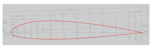

The Kawanishi H8K root airfoil appears to be a NACA (2.7)516.6 (a NACA 3516 with camber reduced from 3% to 2.7% and thickness increased from 16% to 16.6%)
