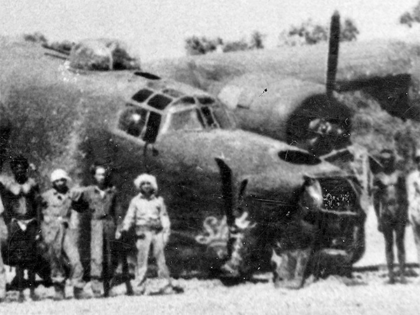

Just by way of comparison to the 160 sqn 24hr mission covering 3,735 miles in Aug 1945, there is the "Shady Lady" raid nearly two years earlier.
In what was then believed to be the longest sortie to date the B-24D-53-CO "Shady Lady" from 380th BG, flew from Fenton, NT, Australia via Darwin to Balikpapan and back to crash land at Drysdale Mission in 16 hrs 35mins. That was on 13/14 Aug 1943. It covered some 2,700 miles, carrying a 3,000lb bomb load and again encountered some atrocious weather. They even released a movie about it in 2012.
It illustrates quite clearly how the Liberator was stretched to greater and greater feats as the war went on.
