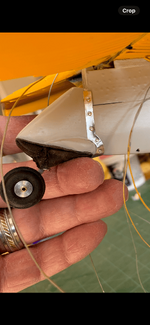

Tail wheel:
It turned out to be one of those items I just couldn't replicate as seen in the b+w photos. I first cut out some plastic that closely resembled the photos. Then I used a heat gun ( hair dryer ) in attempt to bend the plastic to that of a fork.
Unfortunately I didn't have either enough heat or the plastic I used wasn't suitable for the task.
In the end, I followed Westburg's outlines in his drawings. It was sort of a compromise between the two worlds.

Moving forward: I used a handkerchief for the tail wheel covering. It was first glued on using lots of CA, followed by painting it a dark tan/brown. Since the majority of my photo sources are in b+w, I could only guess that leather was used & that was what I sought after.
I used a strip of Flite Metal embossed with simulated rivet fasteners to cover the gap between the rear fuselage & the tail wheel housing.
A little bit of artistic license was used and I left the strip in its polished aluminum finish.
