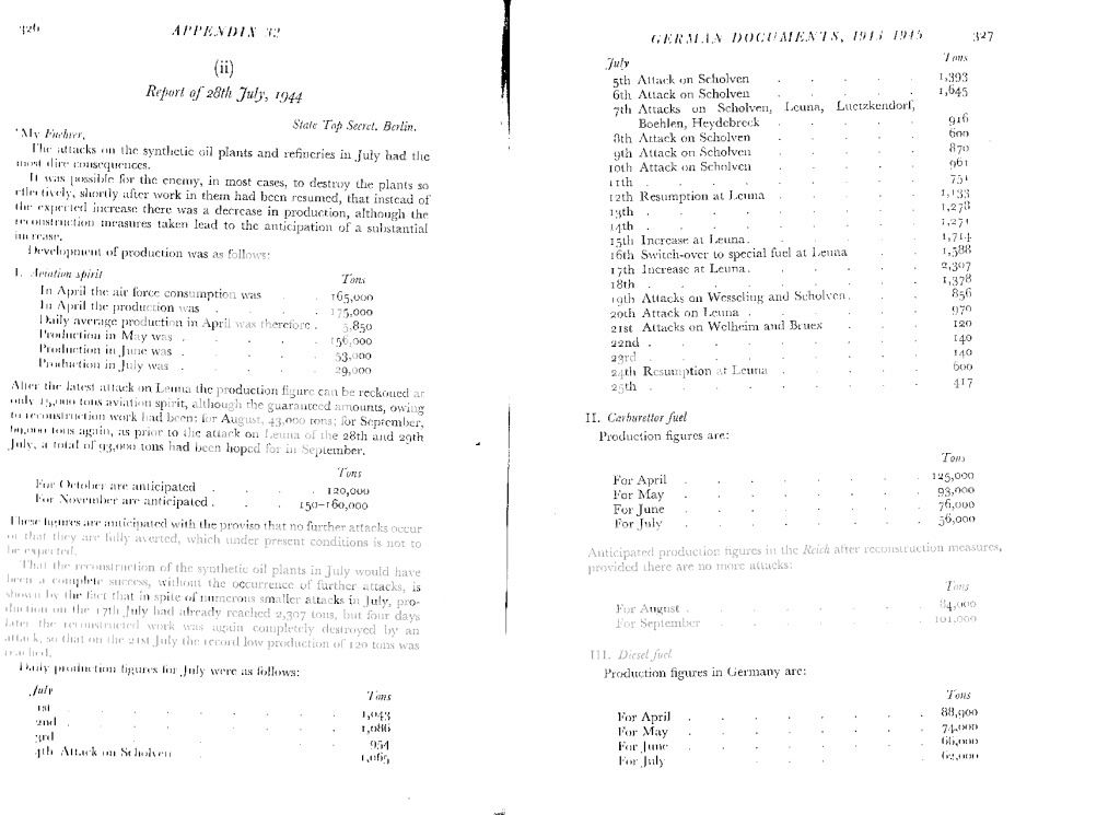

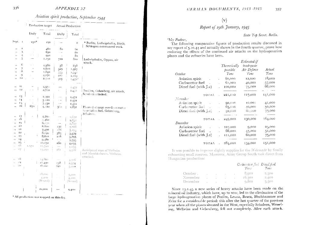

Download to disk, zoom in. The policy-making whys and wherefores of the RAF's involvement in the oil and communications attacks of 1944 onwards, from the Official History.

The text begins with an indictment of Harris' under-estimation of his own force's capacity for accurate bombing during the pre-invasion campaign to shut down the French railways.

to further illustrate my point:
For January-April 1945 the following total—supplies can, according to the, present position, be reckoned with, that is including the Hungarian
production ::
—•Estimated
January Tons
Aviation spirit ... 13,000
Carburettor fuel 68,000
Diesel fuel (with J.2) 73,000
Total ... 154,000
if Theoretically inadequate possible.
—• AirDefence.
January Tons.
Aviation spirit ... 12,000
Carburettor fuel 60 000
Diesel fuel (with J.2) 65,000
Total ... 137,000
so in a nutshell: planes the LW had, Pilots the LW had. chemicals for the planes they did not have. I also think that the glory of the P-51 should be put into perspective too, as the above data would seem to say. limited fuel.. do you attack the heavies, or the fighters? Goering said heavies(in this case all day/night fighters attack allied heavies), Galland said fighters ( in this case only the Bf109 attacking allied fighters). This applies to mid 1944 doctrine. so what won the air war? certainly not he P-38/P-47/P-51. It was the allied Heavies.
