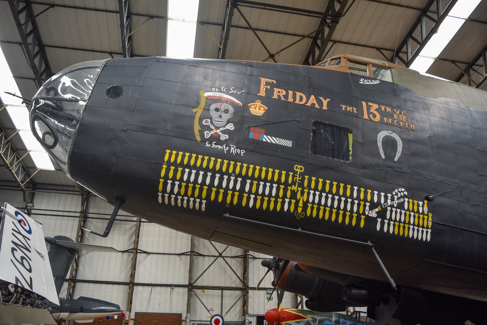

I saw (and heard) these two critters running up their engines at Elvington, it was like some Sci-Fi mechanical mating ceremony.
Elvington is an awesome place, very evocative and the runnable Victor - not actually owned and operated by the museum (not sure about the Nimrod) - certainly adds to its character. A highly recommended jaunt for any UK visitor.
YAM 07
YAM 08
YAM 12
My fave from the collection, the only place outside France you can see one of these.
YAM 04
Of course, the reason for the place's being was the desire of the founders to recreate a Handley Page Halifax, and the reproduction they have built is a magnificent effort and a story in itself.
YAM 25
Images here from my last visit to Elvington:
