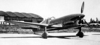

There's this:
NAA lightweight proposal with very little defining documents. Purported to be from a Japanese publication, supposedly designed by Edgar Schmued.
However, little to no references that can be checked anywhere I can find. Looks interesting, but none of the "lightweight" fighters ever made much of a world impression in actual use. Caudron C.714 came as close as any.
Still, it didn't amount to much after all the effort to make it work. Looks good, anyway.

To the best of my knowledge, the P-500 never left the paper stage and didn't even get an NA project number assignment.
At least Bell built their concept (XP-77), unlike Douglas or Tucker's proposals, which at least were given AAF designations (XP-48 and XP-57, respectively).
All - that IS the Ryan powered P-500. It was a LW fighter concept, funded under SC-46 that preceded the NA-53 for export. The SC-46 was a Shop Charge for mock up. My Co-Author represented it in scale along with the P-509-1, -3, NA-73X, NA-73. What was fairly common between P-500 and P-509 was the General Arrangement and wing/fuselage and empennage.

Below is the P-509 artist sketch, the mockup completed on April 16/17 1940 and the engineering three view attached to the Report NA 1592 Specification High Speed Pursuit (Allison) dated March 11 1940. To be clear both the radiator and oil cooler matrix are behind the pilot and imbedded in the fuselage.
Approximately December 1939, the P-509 General Arrangement was completed, in which the layout of the engine, cockpit, fuel tanks, radio,armament, cooling system, major airframe component, etc. volumes and weights were calculated to locate a CG, about which the wing and empennage were sized to estimate performance. The P-509 as shown and presented in March and mid April morphed considerably as the RAF/BAM/RAE and NAA engineers discussed mission and mission requirements. The P-509 grew approximately 10%+ to result in NA-73X and continued to be tweaked following release from Preliminary Design engineering or about Agust 1st as more wind tunnel data was received frm GALCIT.
