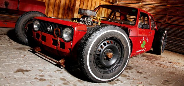

Its funny you say that its been done people have shoehorned a v8 in a golf. So the sabare thing is possible
Sure, ruining the aerodynamics and probably the range of the -51 in the process.
A fighter plane is a weapons system designed to deliver ammunition onto target. You cannot simply swap out components like Lego blocks without seeing changes elsewhere in performance, for both better and worse.
My post about the VW Golf was very much tongue-in-cheek.
It's only possible to install a larger, heavier engine in an aircraft if you can demonstrate, through correct engineering calculations, that the new weights and balances are suitable, including whether the wing in its current position is sufficient, and whether the existing tail is long enough. You must also demonstrate that the aerodynamics of the aircraft are sufficient to maintain or improve performance.
Changing the engine in an aircraft is a much more complex proposition than it is for a VW Golf. Cars only have one primary vertical force working on it: gravity. An aircraft has 2: gravity and lift (and, yes, lift isn't a vertical force but it always has a vertical component). Get the centre of pressure (centre of lift) wrong on an aircraft and there are no end of problems, and the centre of pressure is entirely dependent on the relative position of the wing and the heaviest airframe weight (typically the engine). Having the centre of pressure too far aft provides insufficient compensation for the weight of the engine, and the aircraft will dive with no means to recover. Putting the centre of pressure too far aft and the aircraft will perpetually stall and or become so unstable that it can't be safely flown. These are problems that you MUST consider in an aircraft but which are irrelevant to a car (VW Golf or otherwise).
The VW sits on the ground and doesn't need exact calculations to enable it to operate.
Just making a statement like "oh, I like this engine better, so we should put in here" doesn't take into consideration the physics involved.
The P-51, which had a compact fuselage, was designed for the Allison. It is fortunate that the Merlin was close in size to the Allison, which enabled it to make the transition.
The Sabre was twice as wide as the Allison. So you would have to make the front of the P-51 as big as a P-47 in order to make it fit. Now you have to rebuild the frame to hold the engine and make weight adjustments around the airframe in order for it to safely fly.
So trying to put a Sabre into a P-51 would be more like trying to fit a Viper V-10 into a SMRT car...
Take another another look.
That is not a Golf with V-8 engine.
It a a custom chassis (rear drive) with a V-8 engine and Golf body panels draped over the out side.
Using this approach we can simply take a Typhoon, cutaway a lot fuselage panels, weld in some supports and drape some Mustang body panels around it, and just leave any gaps and holes.
The result ought to climb pretty good. It might even turn fairly well at low speed but it will NOT be fast, or do much of anything at high speed.
But is will look like Mustang, if you squint real hard, into the sun, and pretend the holes/gaps are maintenance panels removed for access,
more than few beers will help the illusion ;)
Not quite correct, just that the calculations for an aeroplane have more serious outcomes than for a car (normally). If you could just slot a V8 into a VW Golf you would have a car that maybe went faster for a short time in a straight line only. The drive train would break, the suspension would bottom out, the weight would be all wrong so it would always want to go straight on in a corner, it would have too little breaking and too much body roll. MAYBE faster in a straight line but certainly slower and less reliable than a Golf GTi. This is why the Golf in S/Rs post had the mods it did, it isnt a "Golf" in any way it just looks like one.
