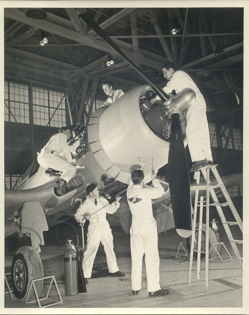

I think you've identified the problem Dan, when you mentioned the cowl flaps would overlap the fuselage if closed. I think perhaps the cowling is too short at the rear end. See if you can measure the cowling length, from the forward joint of the cowl flaps to the front of the cowling, and check against your scale plans. It only looks to be a couple of millimetres, but enough to be noticeable. If you can add an internal ring at the rear, under the cowl flaps, that should bring the flaps into line, and stop the cranckcase protruding. If this is not possible, then I'd suggest you leave it and accept it. Should be possible though. I'll include a piece of thin aluminium sheet (litho plate) which you can use to cut and form a narrow ring. If the cowling is extended, it won't affect the engine or exhausts, and would look right.

I'm no expert by any means, but they might not only articulate to a 45 degree angle, but also extend perhaps?
Im pretty sure they only toggled open and closed Matt, they did not articulate outwards upon opening....
They also had slipper plates between them
Yea I got that covered, this was just the dry fitting... I still have to spray the pieces and also work on the cowl flaps ring some, scratchbuild this, trim down that....
Terry, by looking at the pics I took and comparing it to scale drawings off the measurements I took, the cowl is the correct length, and the crankcase is protruding only about 1/2" scalewise, which I can deal with.... The damn cowl flaps scale out at 2" too long, so they definatly need to be trimmed down....

Well, I tweaked and cut and sanded and tweaked, and I think I got the cowl flaps pretty damn close to the real thing, which were rectangular flaps with a triangle sized gap between each one....
